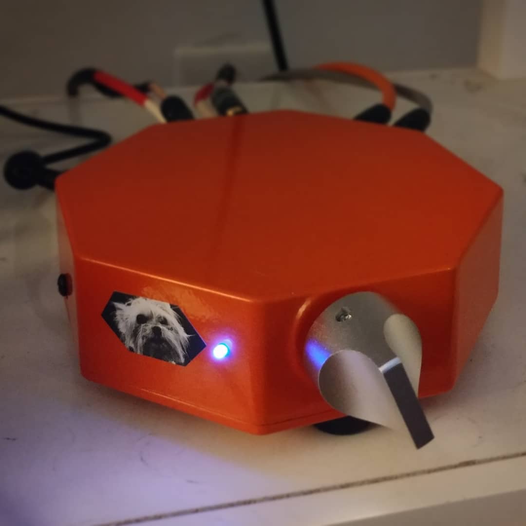

Semi-related: a picture of a little amp I made with some $3 LM1875 modules from Aliexpress.
