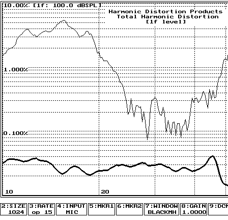

DVC 15 in distortion with DEQX EQ at listening position to 50Hz.png [ 3.53 KiB | Viewed 32456 times ]

With EQ, at my listening position which is 11 feet from the subs, the response is flat to 10 Hz. Since the 4 DVC 15 drivers have so much linear volume displacement, the distortion barely exceeds 5% at the higest point. This measurement was taken with only half of the subs working for a comparison with the single 18" Ultimax kit I was testing for the magazine. In reality it represents a measured 106 dB at that level.[/quote]
So getting to 10 cycles with really low distortion sounds interesting, but does anybody really need 106db in their listening room???
I'm not playing devils advocate, or passing a judgement in the form of a question. I'm asking because I really don't know!
