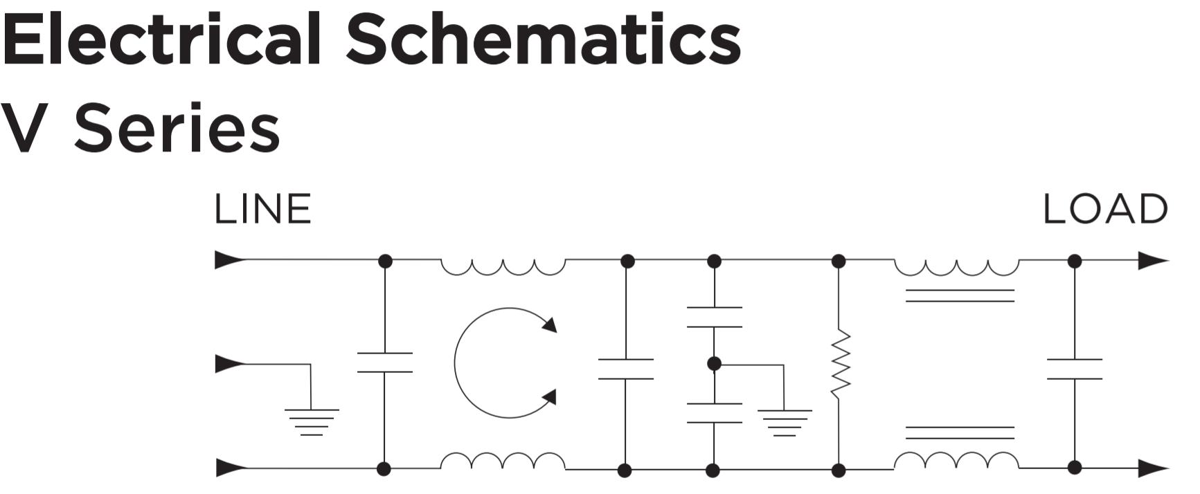

If you look at the circuit diagram of the Corcom filter, there are only two lines plus a ground. They do not differentiate between a hot and neutral line. In fact, when the Corcom is used at 240 volts on a traditional split phase, ie balanced center neutral house feed both inputs are hot. The key to the figure is that both lines have inductors and capacitors in combinations that shunt a lot of the noise from either lead and either polarity to ground regardless where it comes from.

Since the utility transformer cannot put out common mode noise, where does it come from. Generally, it is picked up as RF noise on the lines either coming into your house or on the wires inside your house. Remember that devices in your house like motors can create differential mode noise feedback to the house power lines and also radiated common mode noise. If your device has a power transformer it will also reject that common mode noise to a very high degree. If it has a switched mode power supply the incoming voltage will be converted and filtered to DC which will then feed the switching supply, also removing incoming common mode noise. To supplement this rejection of common mode voltages which get converted to common mode currents, most competent noise filters like the Corcom mentioned utilize common mode chokes that reject common mode currents. A link to common mode chokes is included. Also included is a better circuit diagram. If you look at the diagram you will see that the filter first has a line to line capacitor to remove a lot of differential noise. Following that is a common mode choke to remove common mode noise. Then there is another line to line filter. Next is a line to line filter center tapped to ground which could further filter common mode noise to ground. After that are a line to line resistor, two chokes and another lint to line filter which I believe, although am not sure act like a pi filter to reduce RF effects that may have gotten through.
So, looking at this you can see that a filter like the V series Corcom can do a very effective job at reducing both common mode and differential mode noise regardless of whether the source is balanced or not. Also, with some of the suggestions of connecting one or more isolation transformer secondary connections to utility neutral defeats the main purpose of an isolation transformer, that is to provide safety from the secondary to ground. If you connect any part of the secondary to ground you are as likely to get a life-threatening shock as without the transformer.

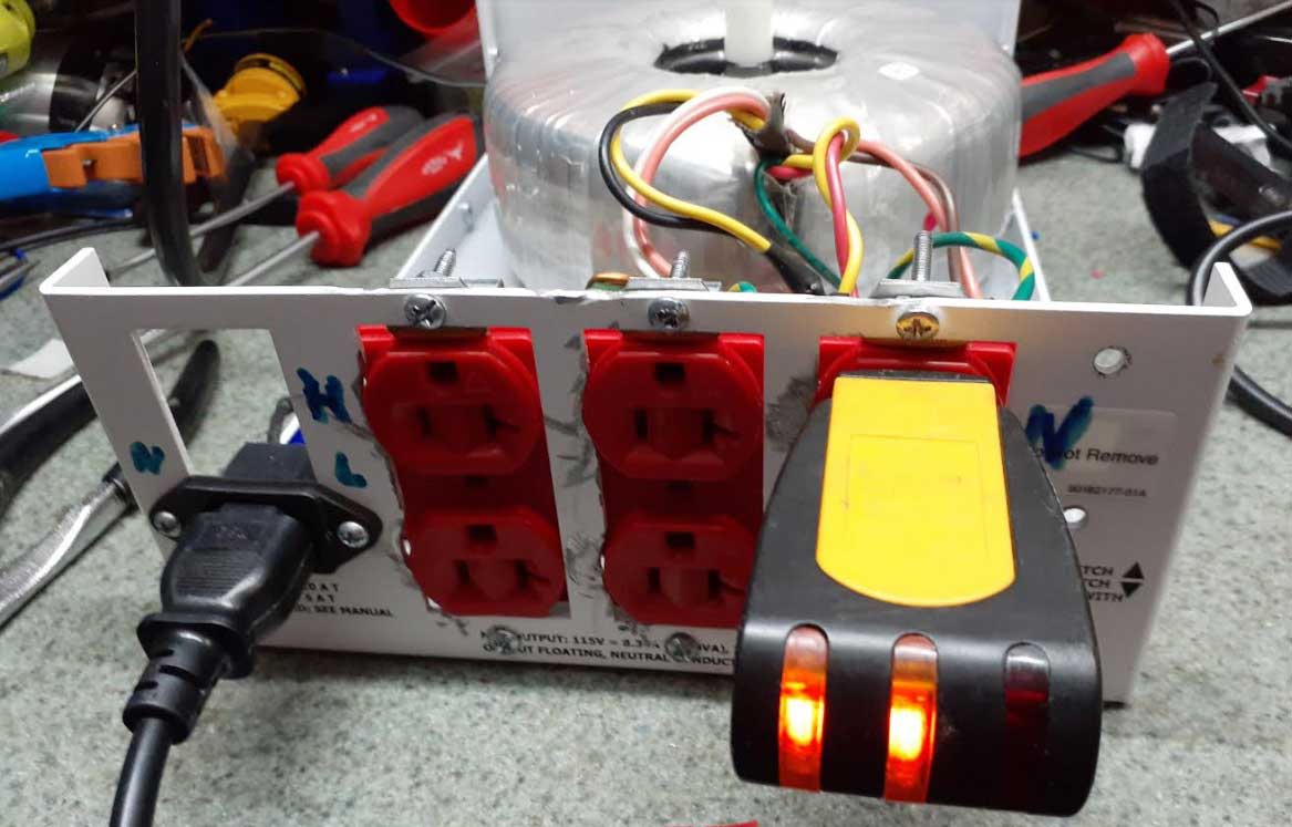

I finished the rebuild with ground isolated sockets. I made sure of polarity integrity throughout. I also separated the secondary's with one socket on one secondary for 3.5A AC and the other secondary supplying two sockets just in case paralleling the secondary was the problem.
I still have the open ground probably because I did not follow Stu's schematic. I just want to know if I understand it correctly. The schematic shows the neutrals and grounds on the secondary side are bonded to house ground.
Since all grounds are bonded together at the chassis, then all I have to do is connect the secondary neutral to the chassis.
PostPosted: May 11th, 2020, 3:36 pm
Yes.
PostPosted: May 11th, 2020, 3:38 pm
thanks
but do i still have isolation
PostPosted: May 11th, 2020, 3:52 pm
yes that works

PostPosted: May 12th, 2020, 5:10 pm
Ok put the iso back into the system
I carefully listen to a hires trak a Holly Cole
DSP 128 She has a deliciously smoky voice that tends to pull one into the song.
I listen "They Can't Take that away From Me twice through with no ISO, no 10ga power cords
then hooked up the iso with my 10ga power cords and listened again
if there was a difference I would lean towards the iso, but in a blind test I doubt I could tell you which is which.

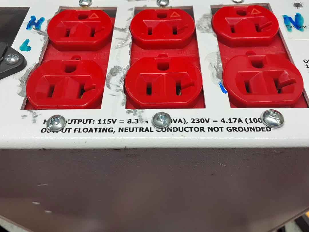

ok as I was putting the iso back in I noticed this:
so the original unit was wired without the ground floating on the output side
and the unit probably would have shown an open ground.
confusion again
its dead quiet, probably better than it has ever been
