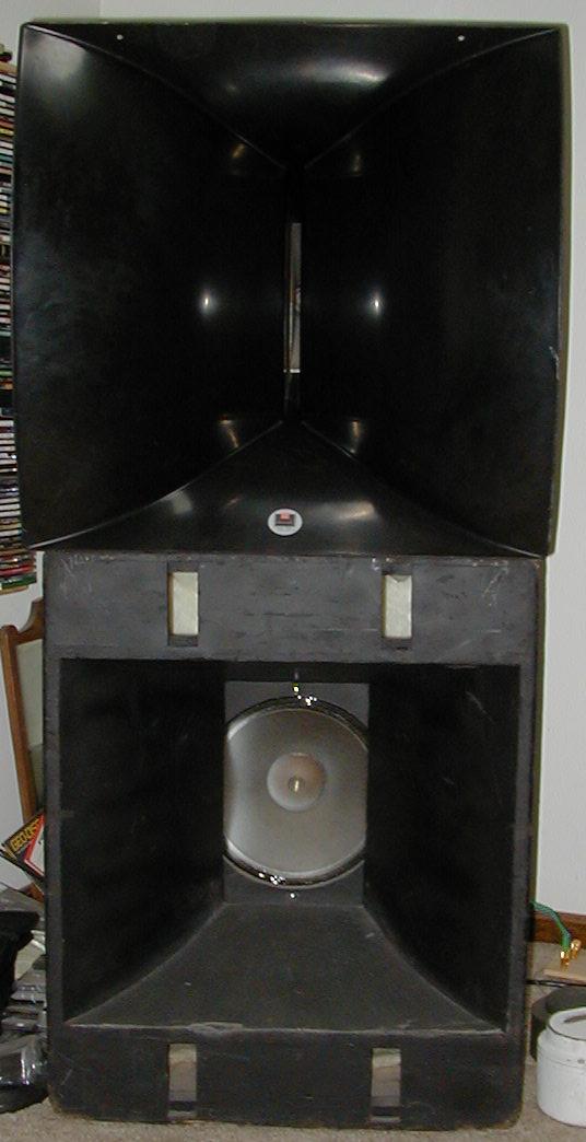

Posts: 1737
JDCrae wrote:
What could you possibly power with 3/4 of a watt?
I used to have these:
in my living room (they're in the garage at this point). For scale, the HF horn is 31" square, and that's a 15" woofer in the bottom. At 3/4 of a watt, there'd be no quiet place in your house ;)
3/4 of a watt into speakers that are 105dB/w/m is more sound than 50W into a pair that are a more typical 86dB/w/m...
