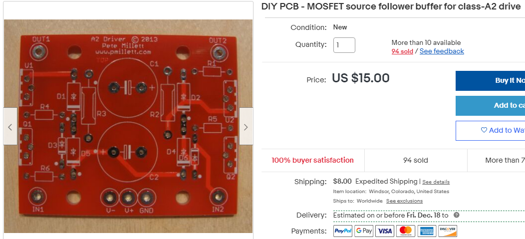

So, while the rest of you were arguing about guns & who has the best geriatric friendly exercise program, I built an amp. Yes, AN amp, can't find the parts to build a matching channel using the same parts... Mouser here I come ;)
Dead quiet, and gain is pretty low, but definitely worth building a second one, will give another update when I get the other one built...
Curious why you chose to drive the screen from the plate of the voltage amp, rather than use a follower (SS or tube) direct coupled to the grid with lots of standing current and a very low output impedance? Was it simplicity, elimination of a third stage, or other reason?
Slick
PostPosted: December 11th, 2020, 2:29 pm
Posts: 1733
Slick
Simplicity. Also, the choice of driver takes that into account, with about 45mA of standing current....
