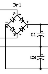

I did this once, I don't remember exactly what I did, but it seems to me if you us a bridge rectifier and two equal sized big caps to rectify the mains to plus and minus DC, you should be able to put a resistor divider between + and - and measure the middle point. It should be zero volts. You want to do this to the mains, not through a transformer. Make sure your caps are rated for the voltage.

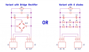

you just described the DC blocker circuit sans resistor

here is the link
https://www.atlhifi.com/shop/fully-assembled-devices/dc-blocker-trap-filter-assembled-in-case/

Not exactly. I was talking about a standard power supply like this one:
The AC mains to to 2 and 3 on the bridge rectifier, the resistors go across the two capacitors. Leave the junction of C1 and C3 floating - don't tie it to ground. Measure the voltage at the junction of the two resistors/capacitors to AC ground. You'd want resistors that are matched as closely as possible to get the most accurate result. Keep in mind that the AC will rectify to 1.4 times the line voltage. I predict the result will be zero volts DC.

DaveR wrote:Not exactly. I was talking about a standard power supply like this one:
