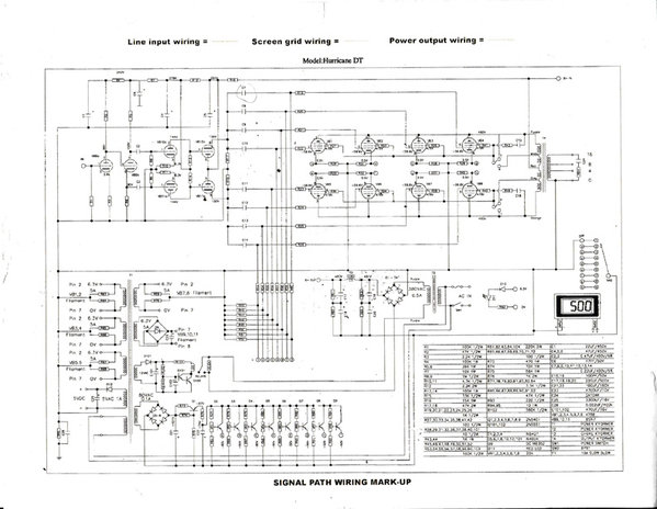

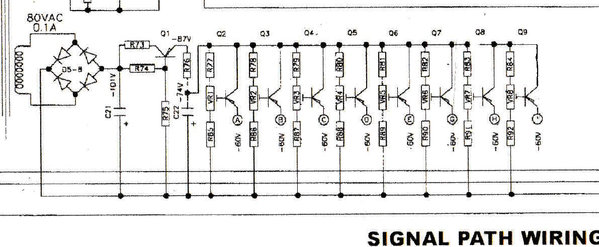

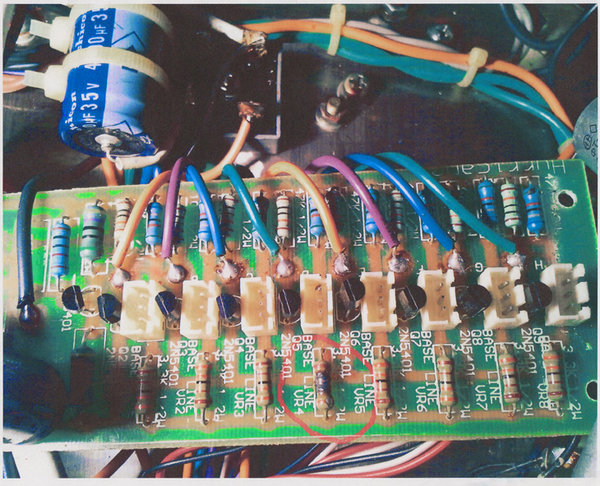

Sorry I got away from this thread since I started it. The history here is I had these two Antique Sound Labs Hurricane monoblocks rebuilds on the back burner way too long. I practically gutted them and replaced many of the passive components. I got one working and had problems with the other. I got busy with other things I deemed more important so on the shelf they went. So now I decided to revisit them and finish the project. The biasing circuit is very troublesome. I want to get rid of the circuit board and simplify. things.
I thought about self bias but after seeing your responses I decided not to go with self bias. I like the way this amp sounds and do not want to do much to change its character.
The biasing circuit seems much to complex. I have other KT88 PP amps that just use a pot to adjust each tubes bias. Walt says the transistor circuit is used to isolate the tubes. I do not really understand this. Walt also said I could use a diode to do the same thing. If someone understands this can you show me what to do.

PostPosted: February 27th, 2019, 3:53 pm
I'll jump in. The circuit for each tube provides the D.C. potential to each tube's grid by means of an emitter follower with the D.C. potential applied to the base of the transistor with the isolated output fed direct to each individual tube grid. The idea was that biasing one tube would not influence or impact in some way a neighboring tube. I get that.
Other multi-tube amplifiers that I've looked at simply apply the bias voltage to a pair of push-pull tubes through the summing point of a pair of 220K-ohm resistors -- one 220K-ohm resistor to a grid. Tubes and the resistors in matched pairs are especially required here (especially the resistors should be matched to at least +/- .5%). Although I would used matched pairs regardless. Repeat for the other pairs. Or -- to maintain the individual isolation one can use diodes in lieu of the transistors in a more simplistic manner.
Since the amplifier power stage is tied to the board through Molex connectors and you have the feature of switching the meter to display each tube's cathode current I would -- if I were you -- stick to the designer's scheme. If the transistors do not have a currently available equivalent that can work then I see no reason why diodes could not accomplish the same thing. Biasing each tube separately is desired because I found that even matched pairs, as established with a tube tester, will require a different setting to get the same cathode current. Why? Manufacturing tolerances. The bias pots, the resistors in the circuit, and the transistors are not (NOT!) exact equals. The individual settings to get the same cathode current through each tube compensates for those tolerances.
And finally -- just because other manufacturers design other approaches to get to the same end does not make them RIGHT -- it only makes them different.
