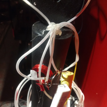

prototyping an xover for super tweeter
out side and hot glue for easy changing componebts

Shashi, I remember you had an gathering at your house soon after you joined the group, to see the progress you were making on your speakers. Your xovers were spread out all over the floor with components connected with allegator clips so you could quickly make changes.
Steve needs to know that one can be a bit loose when working out a design. There are no hard rules.
But for Steve to gain confidence he needs to just get something up and running. In fact he should just hook up the woofer to the amp listen to that. Then add the woofer’s xover and listen to that, to hear what the xover is doing. That is how he will learn.

There are many good reasons for external xovers.
Being able to change component values.
Components not being affected by the vibrations of the drivers.
But being outside gets rid of size constraints, complete freedom of proper inductor orientation.
Easily being able to go to electronic xover and bi-amping
