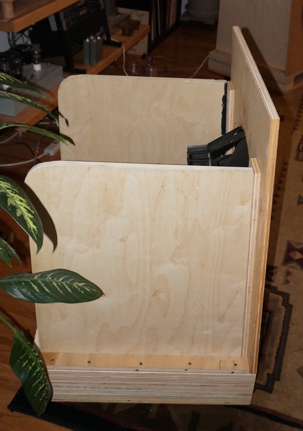

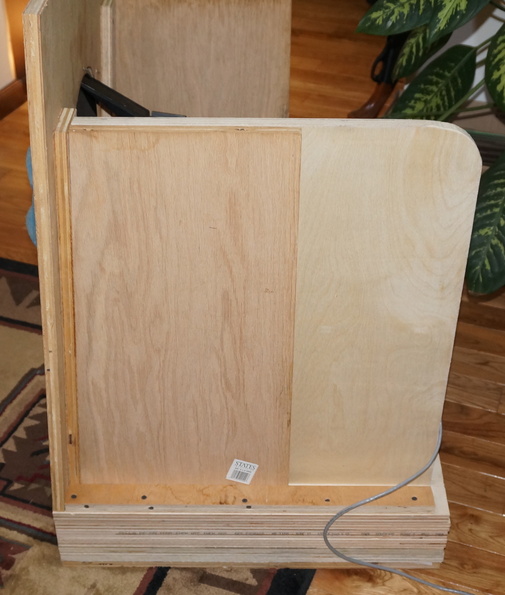

These pics are a little overdue, but here they are anyway.... I made the wings a bit deeper, and rounded the corners to help me avoid injury (again) :sad-roulette:
I also changed the subs to the Dayton PA-465s, which have a larger Xmax & a bit higher qts, the bass is quite a bit more solid now. I could live with these for a while :obscene-drinkingcheers:

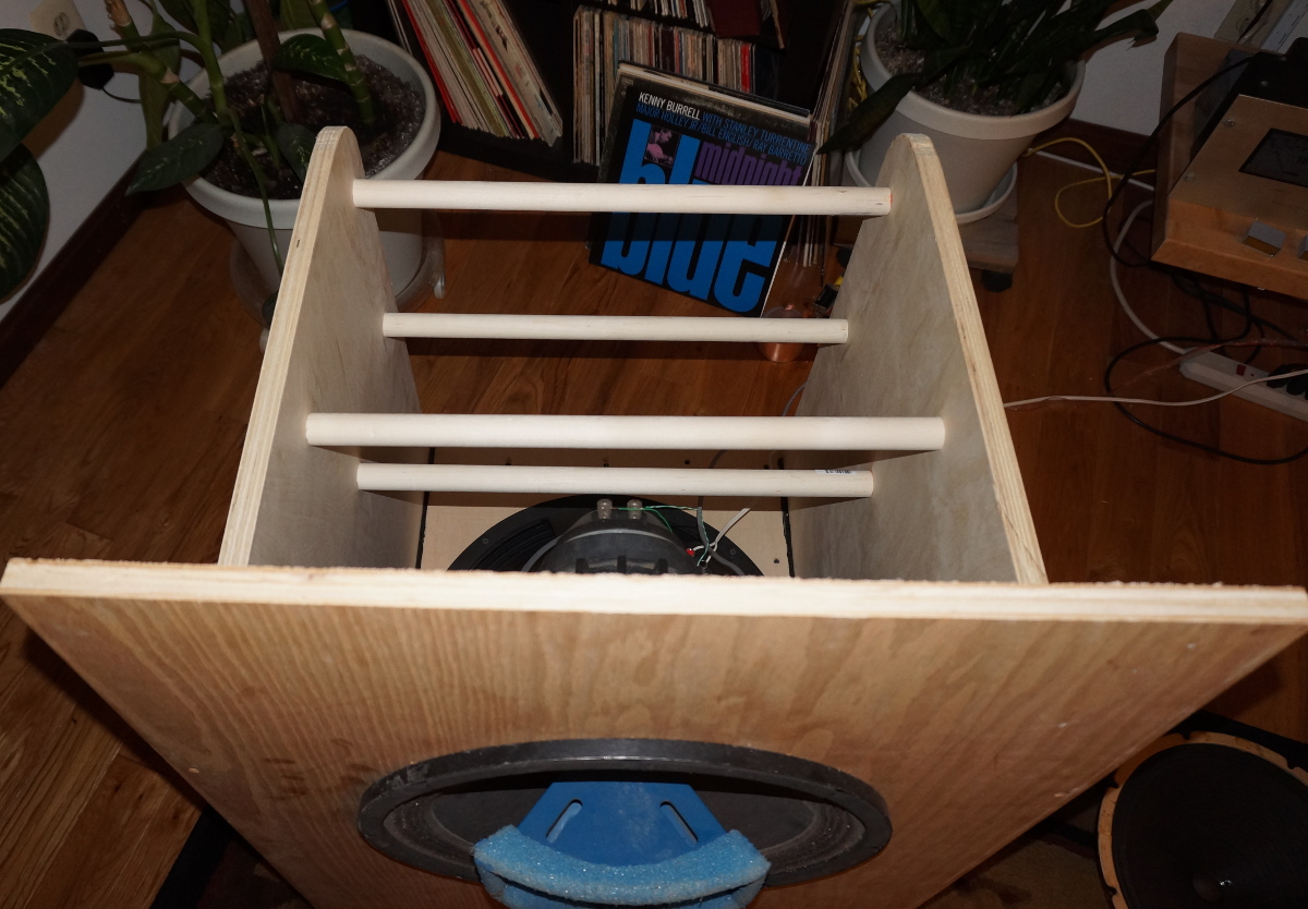

Sometimes it's the simple things that make a huge difference...
Before adding the dowels as cross-braces the wings flapped so much with low bass playing that you could see it, now you can barely feel it. I think I'm going to need to redo the bass EQ now ;)

Yes, there is a huge improvement in the bass since I was there few months ago......

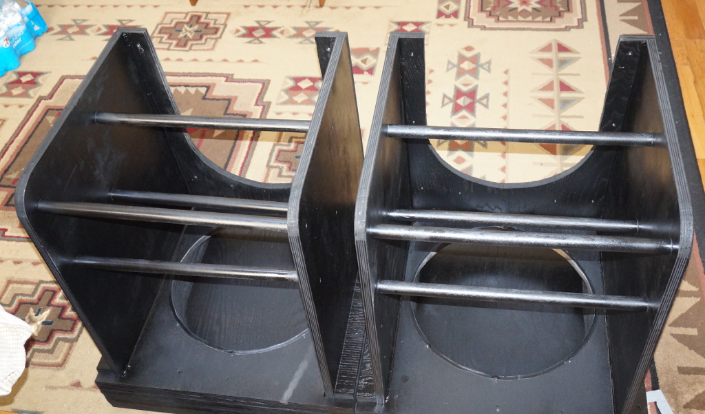

OK, so I'm not the guy you need to see about finishing wood... But, I think they look a bit better than bare plywood...

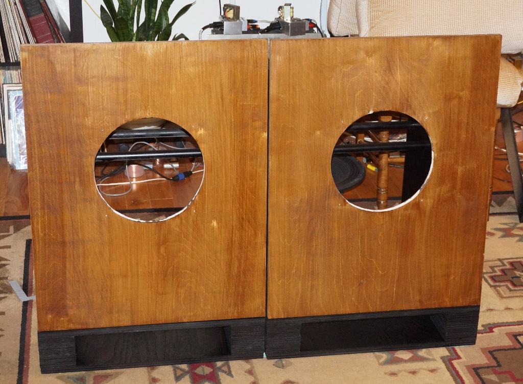

Ok, back together after a second coat of stain on the baffles. Hopefully we won't scare anyone away this year just based on cosmetics alone....

Looks good to me. Ready for the show!
