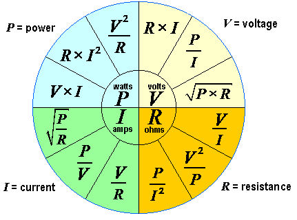

My most important law when dealing with electronics is don't let your body complete the circuit. Ohm's law is right behind that. This wheel helps explain.
