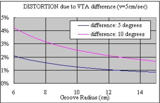

Good paper. The interesting thing about VTA error is how it is frequency dependent which makes sense if you think about the grooves. As the frequency goes up the radius of the groove goes down to the point where a stylus even of the most correct shape vs the cutter has difficulty following it. If you then have the angle of the vertical edge of the stylus at an angle different from the cutter the stylus cannot follow the groove properly and will tend to run across the groove. It will also induce a vertical modulation which is mentioned in the paper that will further distort the signal. It just goes to show what a miracle it is that a properly set up system can sound so good.

As a note on cartridge alignment -- stylus rake angle is a starting point, but all bets are off if the cartridge manufacturer creates a cartridge with the tracking angle (the angular path of the stylus/cantilever) not matching cutter standards. You read cartridge reviews where they go through the measurement drill and the tracking angle range seems to run from the "God given" 15-degrees to as much as 28-degrees.
So much for standards.
