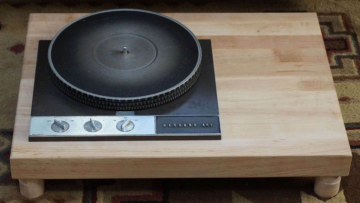

OK, progress has been glacial, but I finally made some....

Hey Roscoe! Were you able to obtain after-market drive components for smooth run?
PostPosted: January 30th, 2016, 7:06 pm
Posts: 1737
Haven't gotten that far yet.... Don't want to rush things you know ;)
PostPosted: January 30th, 2016, 7:42 pm
Hey Roscoe, you getting all fancy on us now?
You might need more mass in the plinth to get it really quiet. That motor throws off some vibrations. Have you tried to run it? Low voltage operation will somewhat calm the vibration as will damping the springs that hold the motor and decoupling the motor wiring loom from the chassis.

is there a particular reason a heavy plinth is considered desirable (effective) for these old tables? I see everyone using these heavy plinths for their vintage tables. I picked up an Empire 208 with tone arm last year but have not worked on it yet, a number of other electronics projects in the cue before tackling that table, but was wondering about the heavy plinth thing...
PostPosted: January 31st, 2016, 1:06 pm
Those big powerful motors shake rattle and roll. With a light resonant plinth you can hear it.
There are various approaches but the blunt force approach of heavy plinth definitely works.
I think the motor in the Empire is a small Pabst, no? These are not that hard to deal with.

The Pabst motor is quite excellent just not a washing machine substitute like the Ashlands and Bodines in Broadcast tables. The Garrard motor is not that bad but there can be perceptible rumble if not addressed. Keep in mind that these were mono-era tables so one dimension of rumble (vertical) would have been inaudible in mono!
For exquisite hi fi apps such as our bud Roscoe proposes, a balls to the wall approach goes without saying...in other words, he might pop for an additional cutting board.
I had pretty good results with plywood RoK plints gluing on ceramic tiles with melamine glue. Constrained layer damping and adds mass.
