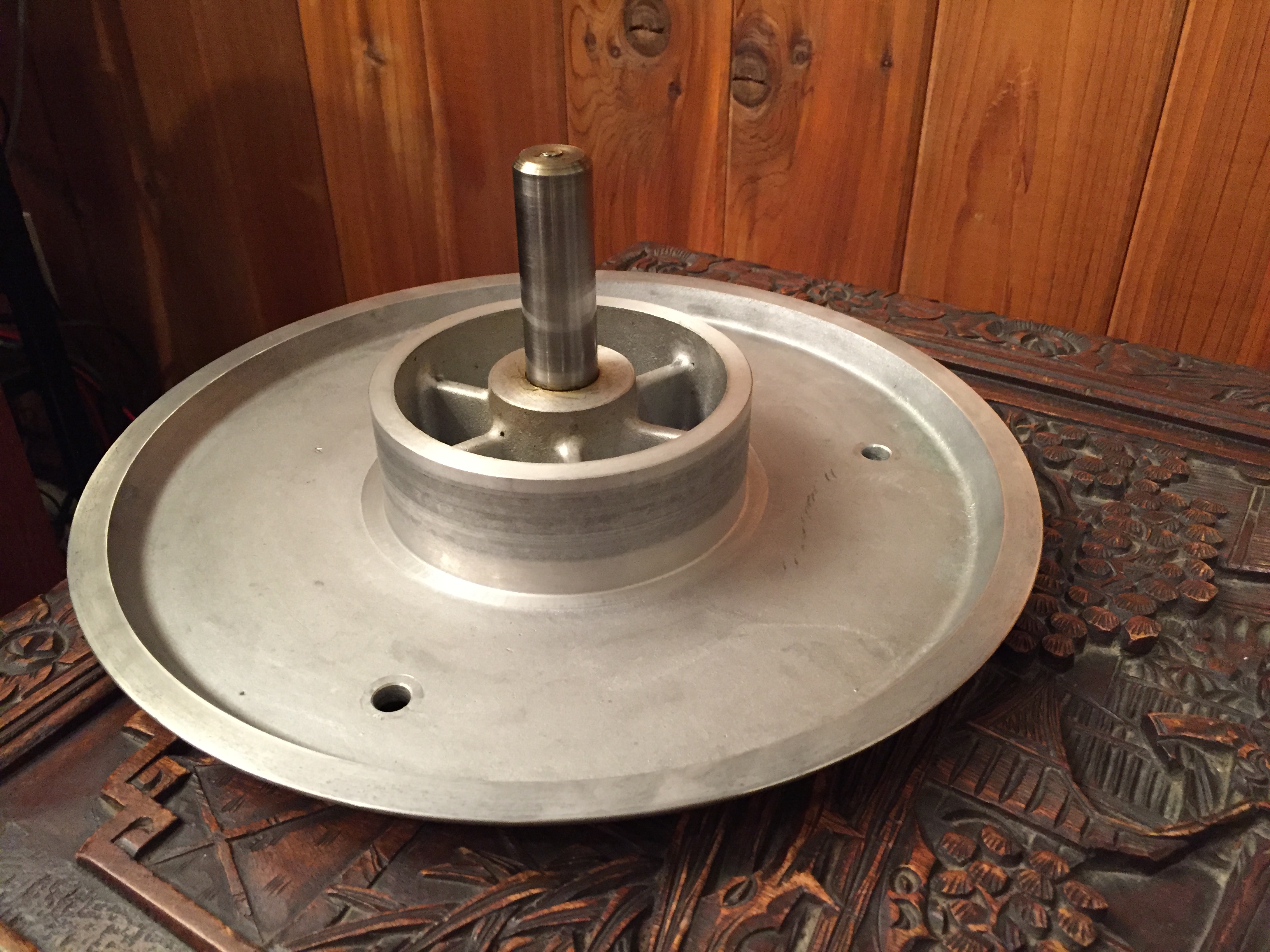

The CB-77 motor (and by extension, the CB-500 motor) is indeed a synchronous motor but this one rotates at 600RPM rather than the usual 1800RPM. That's because the CB-77 idler wheel drives an inside hub on the platter, rather than the outer rim as is common in other idler drives. It doesn't have to turn as fast because it doesn't travel as far per platter rotation.
I think it'd be a little harder to find a replacement motor for this reason.
