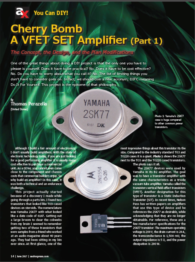

The audioXpress article on the VFET amp is finally scheduled for publication as a two part series. It will appear in the June and July 2017 issues. Here is a view of the first page of the article. BTW, if you do not subscribe to AX, they allow purchasing of single issues as PDF files on their web site.
