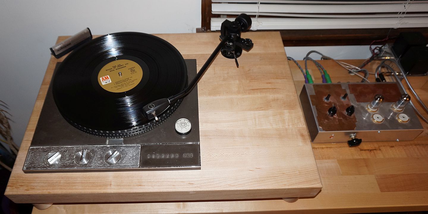

PostPosted: July 26th, 2016, 11:15 pm
It spins!
I decided the 50Hz supply was more work than I had time for, so I put a 60Hz pulley on it.... I may still build the 50Hz generator for the strobe, I think the chip I'm using can drive an LED directly....
Now to finish up the plinth and mount the arm....
PostPosted: August 13th, 2016, 9:43 pm
Now Playing:
Still no strobe, but I'm using one of those free VPI mats, and it's got 60Hz strobe marks on it, so I can get by with household lighting...
