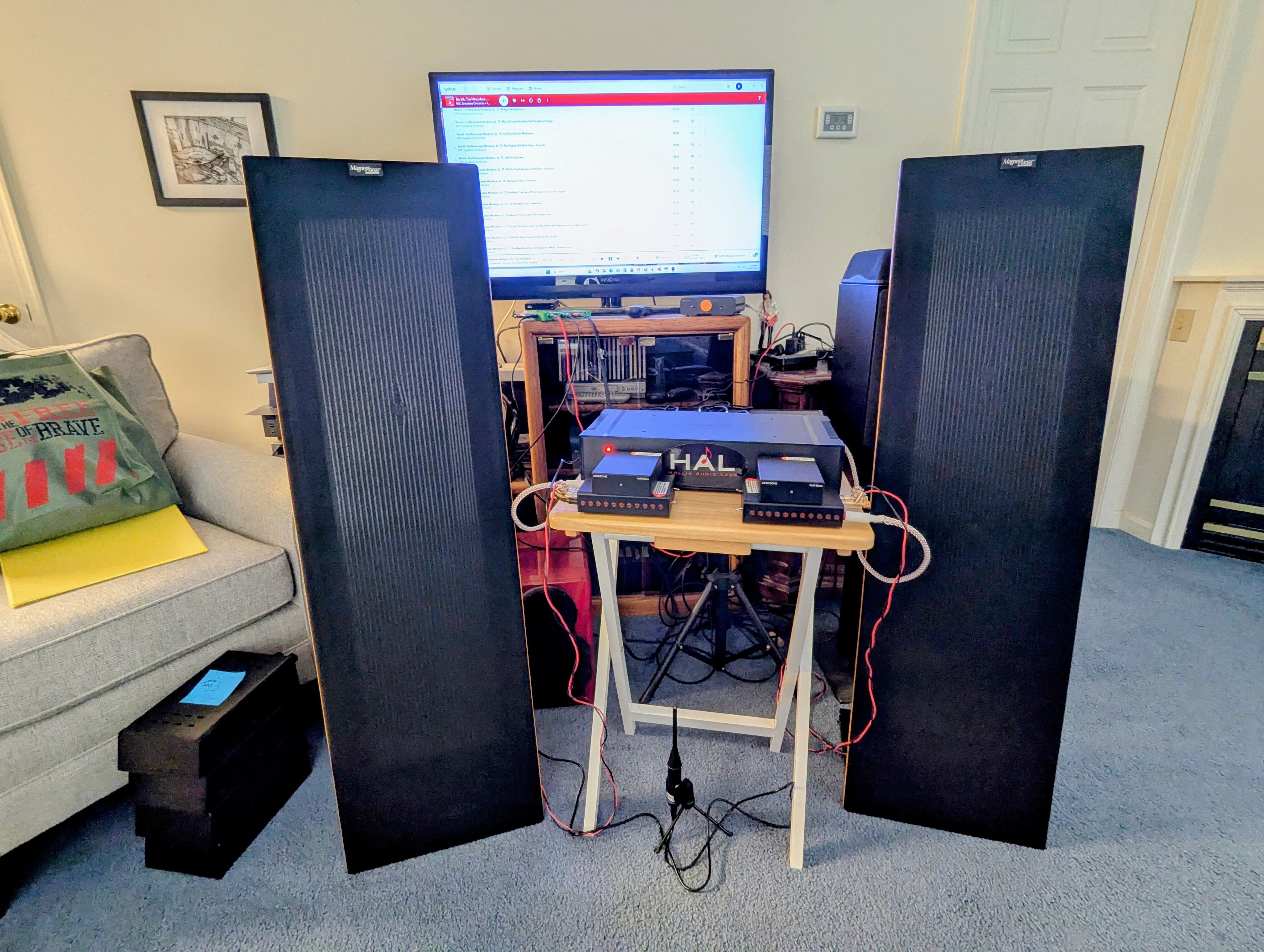

Have my 2 channel XLR to RCA active converter setup with Sparkos Labs SS3601 discrete opamps.
This feeds a Douk Audio A5 Class D stereo amps with SS3602 opamps installed. The stereo amp is RCA input only.
Stock Magnepan LRS speakers for listening.
