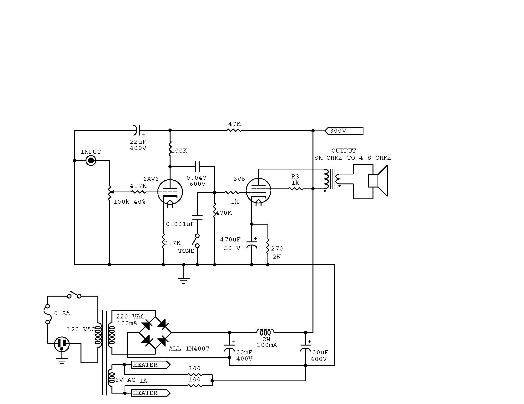

PostPosted: January 23rd, 2026, 12:25 am
Posts: 236
Here is a simple design. Not sure if this works but I will try to add a file.
PostPosted: January 23rd, 2026, 8:02 pm
Posts: 236
Somewhere in the file transfer process some of the connection dots mysteriously vanished. So here is a reposting of the circuit.
