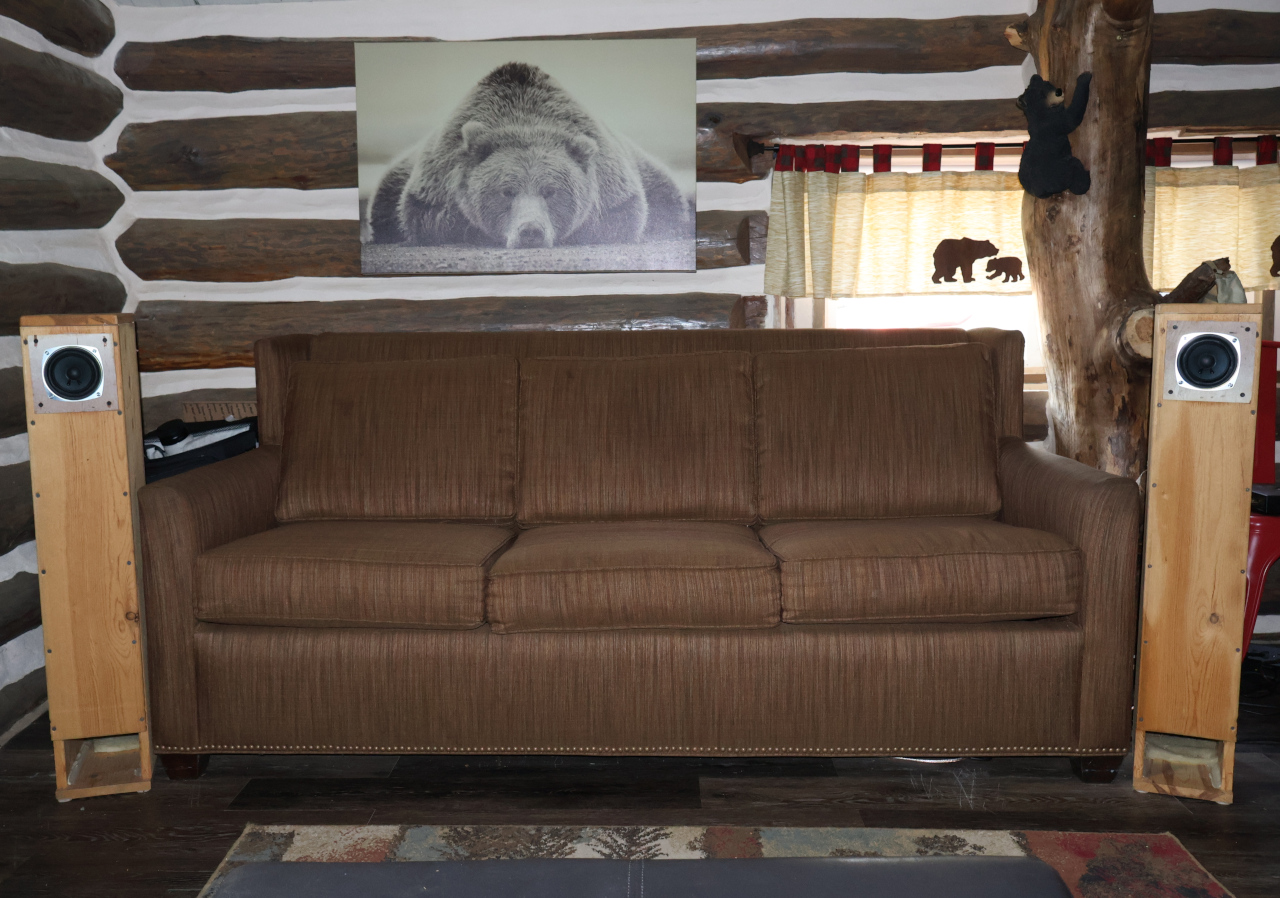

So, I'm up in Wisconsin for the annual family get together with mo Mother's family, 30+ of us come up here for a couple of weeks every summer... So, what's an audio DIYer to do to keep busy for two weeks away from home? Well, I brought my small TQWT cabinets, and 6 pairs of 4-5.25" drivers to try out and compare. Source chain is a WIndows 10 PC running Audirvana (I'm continuing on the Montana this weekend ot visit my Dad, this machine will become Dad's music server, just testing it out for him ;) ) with a 4TB NVME SSD for local storage, and Qobuz for streaming. DAC is my Hugo TT2, amp is a modified QSC 1080. As seen from the listening chair:

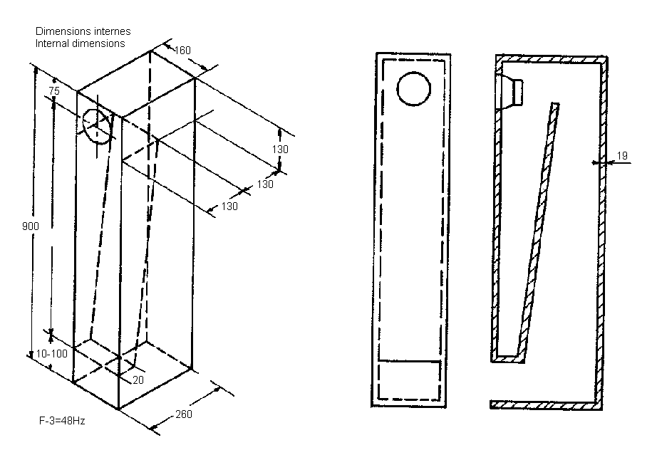

Cabinets are pretty much this design:

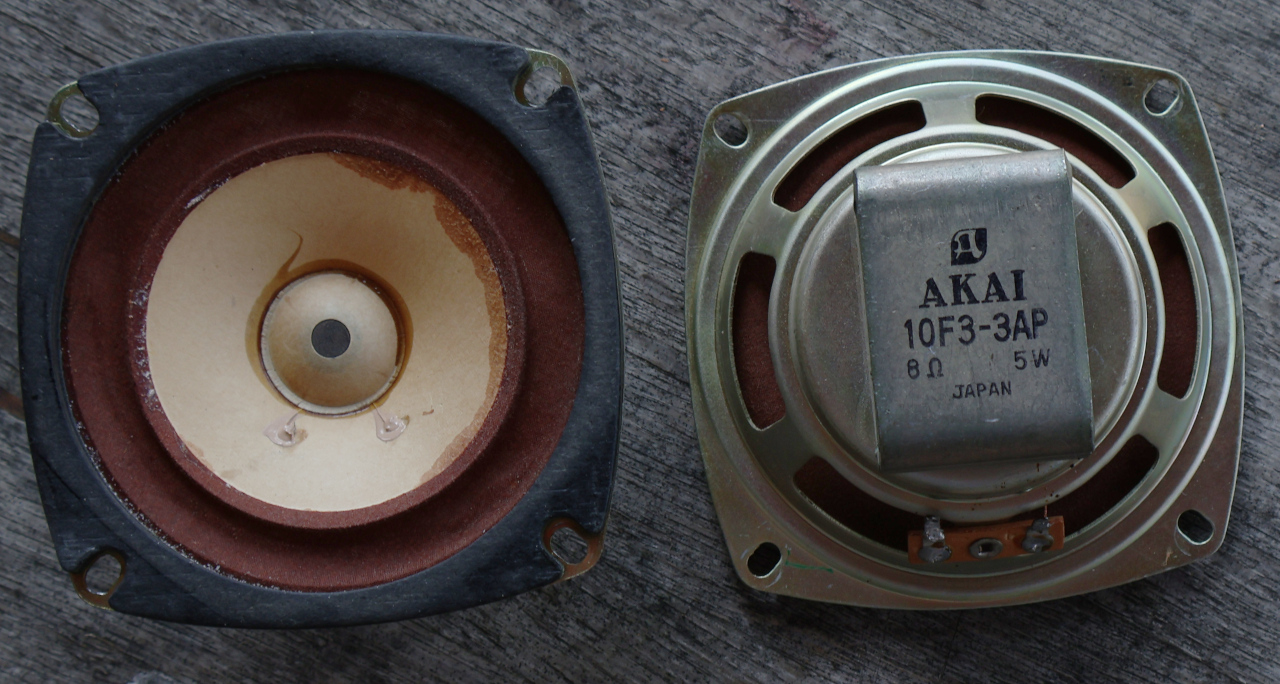

5th place: Speaker #5. These are Akai 4" alnico magnet speakers that were originally used in "portable" reel-to-reel tape decks. These were actually quite good in the mid-range and treble, but had the least bass of any of the drivers I tested. Perhaps in a different cabinet, of with a woofer to help out below 200Hz...

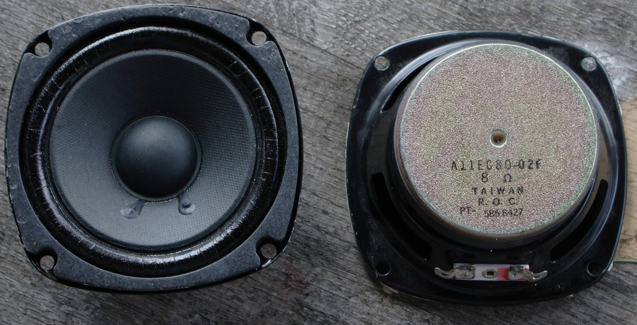

3rd place: Speaker #1. These are a 4" ceramic magnet Pioneer speaker, also no longer made. These have extensive run time in these cabinets, and I have a backup pair. These were a little lighter on the low end than the 4th place pair, but much more transparent and extended on the top end, which is why they snagged 3rd place. Dayton Audio sells a speaker that's supposed to be a drop-in replacement for these, but I have no experience with those.

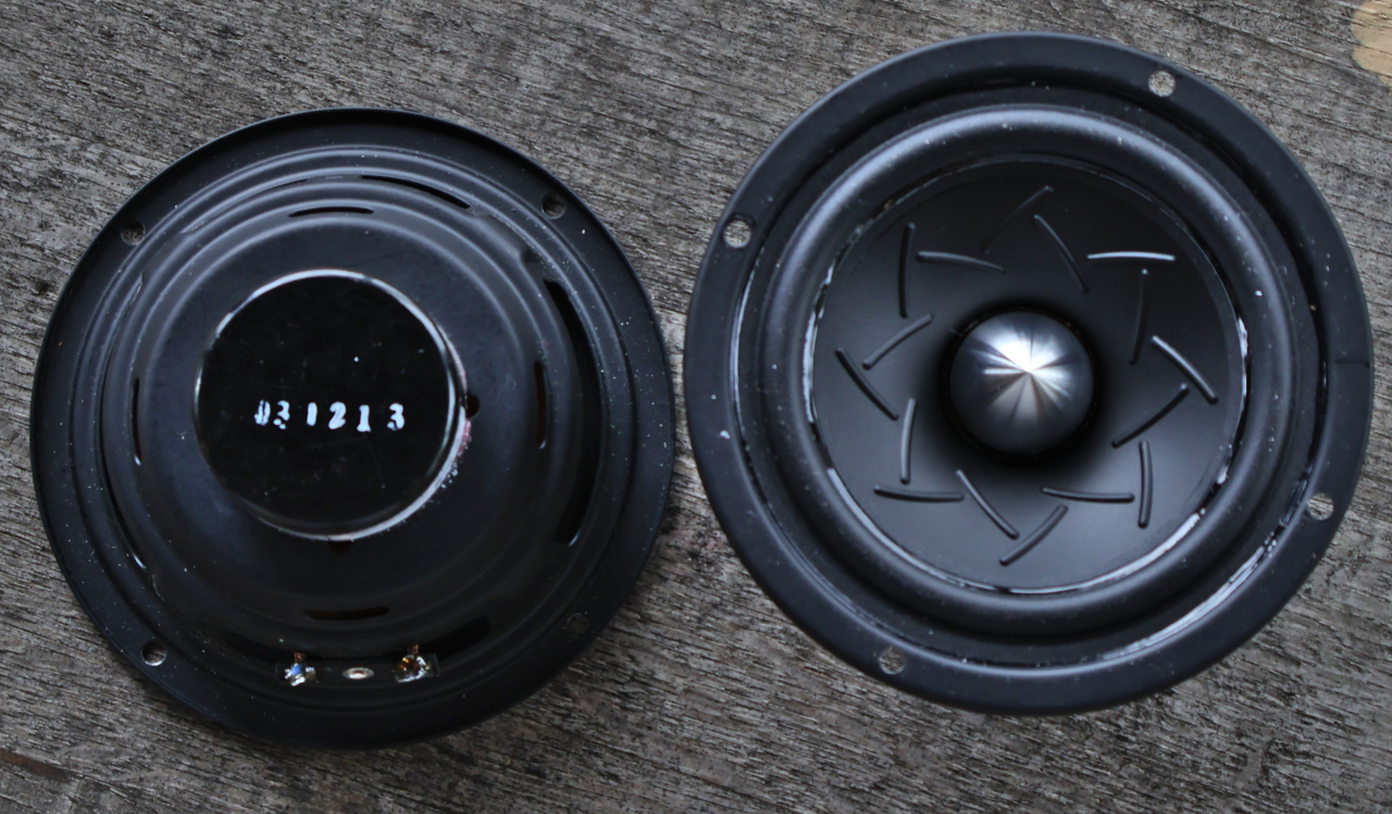

2nd place: Speaker #6. These are a 4" neo magnet speaker by Tang Band. There's a newer version of these still available from Parts Express, but at $62/each with a 50 unit minimum order, I'm not likely to test the new ones any time soon. These were quite good through the mid-range and treble, but while they had a decent amount of bass, it somehow sounded a bit weird. These might be quite good in a different cabinet.

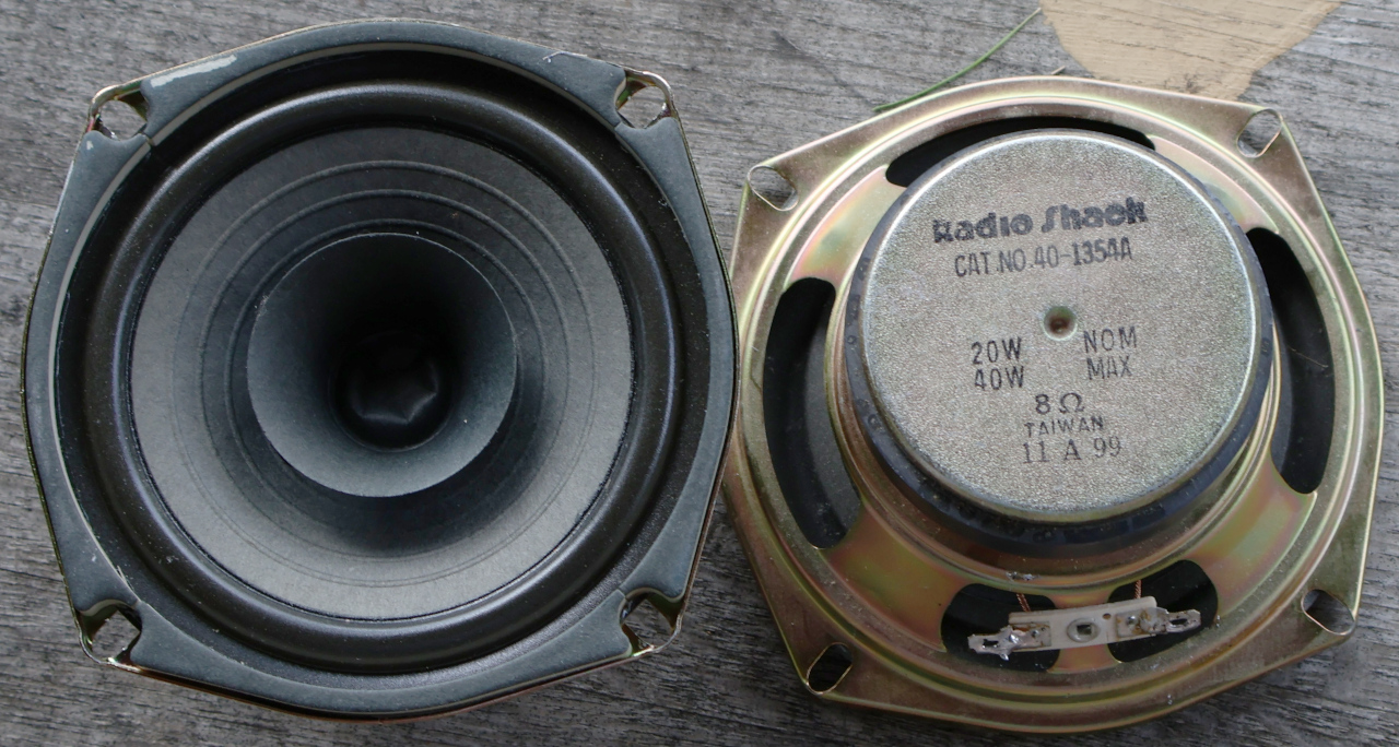

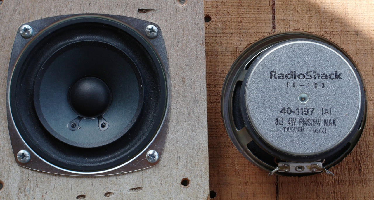

1st place: Speaker #4. These are a 4" ceramic magnet speaker no longer available from Radio Shack. These are supposed to be clones of the Fostex FE-103, but I have no experience with those. As good as these are, they might be worth a try in these cabinets. These were pretty much a match for the Tang Band speakers, but didn't have the same weirdness in the bass. Overall though, the 1st/2nd race was close enough that I had to swap drivers a couple times to decide on a winner... I have several pairs of these that I bought when Radio shack was closing them out, so I'm glad they did well.

Assuming those are the same cabinets you built maybe 12 years ago (or more), any of those drivers would benefit from a less resonant cabinet. Maybe the same design, but made from birch ply or MDF, braced and lined with a damping material. It sounded like a good design in need of a better box.
Your conclusions regarding the tested drivers might change.
