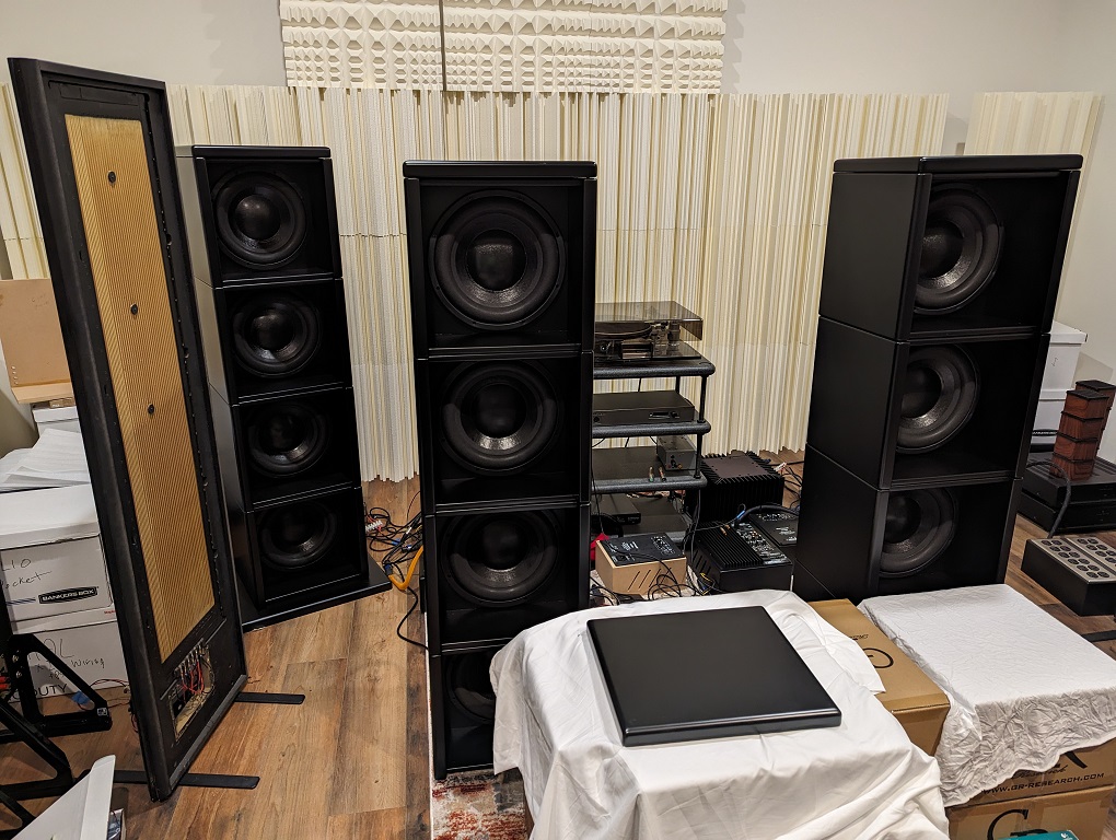

All 12 servo sub modules are complete.
Will bolt the tops, modules and bottoms together in their room locations.
Then build the wiring harnesses from the drivers to the servo amps.

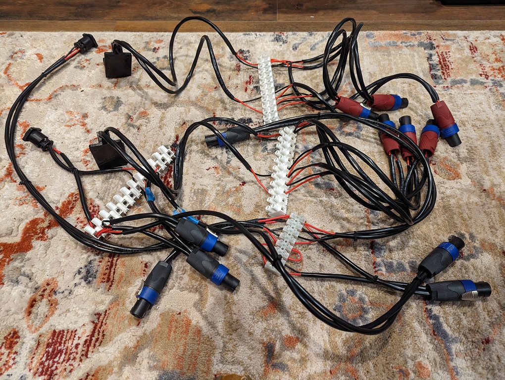

The four cable harnesses from the servo amps to the sub modules are complete.
Now time to assemble the sub towers and test the out.

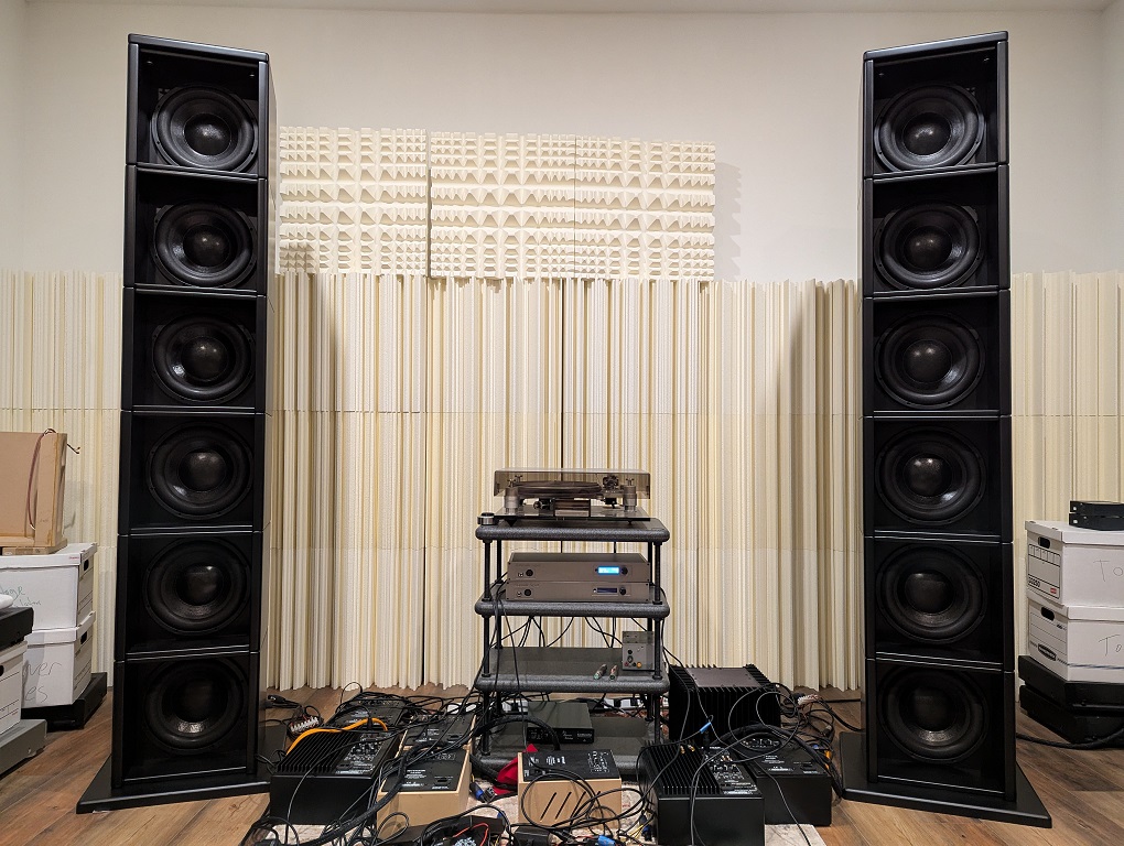

Posts: 919
The new Monolith 6x12 servo sub towers are complete and wired to the 4-HX300-12OB servo amps.
Checked and the first 2 servo amps are up and running. Need to wire up the second pair.
So far, so good.
